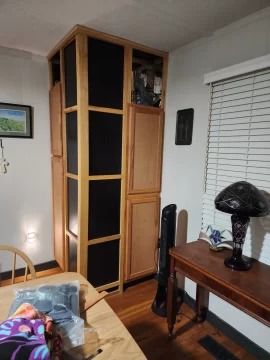

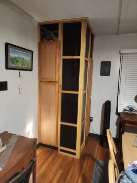

I also don't remember if I ever posted pictures of our chase on the second floor. I'd posted here quizzing about chases/my wife's concern over what it might look like in her dining room/living room. So I'm posting a couple of images of how the chase turned out. Through the metal grills it does add a little heat to the second floor but most of the heat on the floors above the basement where the Matrix lives comes from radiation....and a little from convection as air goes up the stairs. But for the 'look' my wife ended up pleased especially with the pantry and cabinet on the sides. Wives love storage :) We are not carpenters but did the chase ourselves over 3 weekends. We bought the pantry and cabinet from Home Depot. Inside the chase we are well beyond the required air gap and at the bottom there is a 'clean-out' for a hand or a vacuum nozzle for the inevitable dust build up.

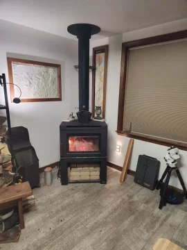

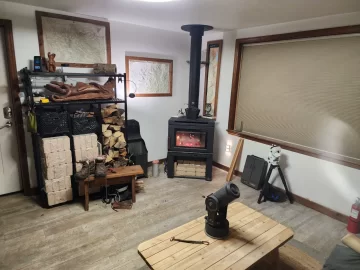

Now the recommendation. No concerns of pyrolysis. The wall temps behind the Mattrix have never exceeded 107F/we are an inch beyond the required offset for this stove. But lately I've been thinking of placing metal on the walls for reflection of heat. I don't need an air gap but I could put one in place with spacers if I can find decorative metal pieces that would please the wife's eye. Our stove as you'll see sits catycorner so I'd place metal on the two walls on the corner.
If any can suggest metal reflective covers for these walls please do! And again behind the sheet rock there is no insulation, just a thin air gap and then solid concrete. There are two maps that would have to move elsewhere but that's OK.

That is a lot of work for a 70 year old me who just came in from splitting wood....with a maul! Yeah I had one small rick that needed splitting. Not enough really to fire up the splitter which I winterized already. I was thinking black aluminum sheet. I can order it already cut to size. Though a spacer is not needed with my clearances I'd put spacers in anyway. I really just want reflection of heat.
Just for curiousity I just went outside and shot with my thermometer the concrete wall opposite the wood stove. 36F outside surface temp (air temp 31F), inside wall 8 inches from the woodstove 97F. I'm probably wasting my time even thinking about this project.
If you want reflective, black is not ideal. Shiny metal is better.
A spacer will help convect out heat and leads to less radiative load on the wall behind the metal. But I think this (spacers) is going to be marginally useful; right now it works. Adding some reflective material to lessen the radiative load will improve things by a bit. Improving that improvement by another 20% with a spacer - is a thing of diminishing returns imo. For the worse looks it'll get (looking from the side you'll see the offset), I would not bother with a spacer.
Regarding the measurements: the 36 F could mean it's shedding a lot of heat to the cold air (i.e. it cools down fast, meaning the heat flow is high). So that doesn't tell me much. The wall could be 100 F if you did not do anything but 40 F if you spray cold water on it. That 40 F does not mean "nothing is happening", it means that the heat shedding of that wall to the outside (water/air) is fast enough to not let it reach a steady state temperature that is high. And that fast shedding means a large heat flow through the wall.

Good info share thanks. Now if I wasn't married I'd go around the whole outside foundation (3 sides of the basement is open, only 1 side is bermed) with closed cell foam and turn all that concrete into heat storage. Speaking of marriage....she'd want black even though not as reflective....but reality is that heat is going out that wall, well both walls since it is a corner and just a little effort would reflect some back my way.

This is a convective stove. It doesn't radiate a lot of heat from the sides or back. I suspect the effect will be mostly visual with little functional gain. Seems like much ado for little gain but stainless panels would be an ok choice.
Begreen thanks so much. I remember you helping/suggesting when I began going down this road. I think you're right=little gain/leave well enough alone.
