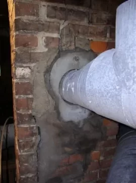

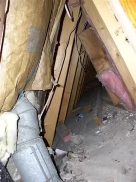

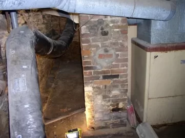

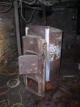

let's see if I can inundate you with pictures.
Here are pictures of the chimney in the basement. Structural engineer says chimney isn't going to collapse or anything. I know it looks bad. The furnace in those pics is gone. There's actually a picture of the orig coal stove, wish I kept it. The picture of the pipe in an attic looking space. The pic is crooked, but where the floor is (this is the hip space by the finished attic) is about where the brick chimney ends and this galvanized looking stuff begins.
For some reason I don't have a picture of anything above the roof (at least not on this computer). imagine that galvanized stuff for about another 2-3 feet. No where near the peak of the roof, FWIW.

It looks like the old chimney will just be a chase. After all the old galvanized stuff is removed, I would guess that it will take transitioning to class A pipe at where the galvanized starts?
Without seeing the roof, it's hard to know whether the current location for this chimney is the best location or not. How tall will the exterior pipe need to be in order to honor the 10/2/3 rule?
PS: I can see why you are considering alternate locations now. If this results in better stove placement and/or better chimney location, it may be worth considering. We ended up tearing out a chimney and putting a very nice built in closet, drawer system in it's place.

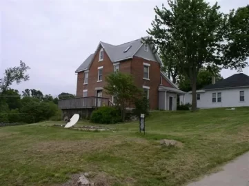

I'm not sure I understand the 10/3/2 rule completely, but if it helps, here is a picture showing the basic pitch of the roof. You can see a skylight on this picture. Imagine that the bottom of the skylight is about the same location as the chimney on the other side (well, actually, more towards the middle of the house, but still the same height up on the roof). I'm not sure what the pitch is, but you can tell it is sure steep. If I had to guess I'd say 14:12 or so. I know pictures can be hard to figure, so estimate that the actual vertical height of the peak of the roof from the gutter is about 10ft.
So, explain the rule to me a little more. Since my chimney exits within the confines of the roof, do I have to come above that peak? or just 3ft up?

The chimney must, in no case, extend fewer than 3 feet above the point at which it penetrates the roof. Then, it must further extend to a minimum of 2 feet above any part of the structure within 10 feet horizontally from it. 3' is the absolute minimum, then you go on up from that point if necessary to meet the 2' above anything within 10' part of the rule. Clearer? Rick
crystal clear. Thanks for repeating something that I likely could have looked up on the forum! I appreciate it. So, since my bedroom is about 15 feet wide, then so is the house, so the midline of the roof is going to be less than 10ft, I need to come to about 2ft over the peak. Gotchya. I guess that means I need about 10ft over the roof if I do this! Seems kind of long and likely expensive, no?
If you have the pitch, and the distance from the peak, then you can pretty easily figure the chim height. That's a steep @$$ roof (maybe 12/12?), so if you're going through a chimney on an exterior side wall, it has to be 8' (rough height to the peak), plus 2'.

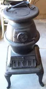

BTW, here is a picture of a SIMILAR stove (I found on this on CL for 65 bucks).
What's the consensus on a small stove like this? easy to use? PItA to cut wood the right size? any other advice? I'm really looking for a small stove that would look right in my very old rustic feeling home. (we aren't talking log cabin rustic, but more like mid 1800s upper-lower to middle class rustic, make sense?)

That's 19th century "caboose". I wouldn't expect much out of it beyond a bunch of "cute" for all your trouble & expense of safely installing it. You're going to have to default to the standards laid out in NFPA 211 for clearances to combustibles and hearth construction. If you're going to press ahead with this, we can help you out with all of that. Safety First! Rick

Pass on this stove. They run like a blow torch. Find a proper airtight.
