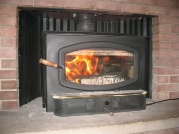

Folks - this is my first post so I apologize in advance if I mess something up. The question of how to get the most heat from an insert/stove is one that is near and dear to my heart. And my (current) solution includes the use of Kaowool. By the way, I got mine from McMaster.com, under the category thermal insulation/flexible ceramic insulation/ultra high temperature sheets. It came in a 24 inch x 25 foot roll.
I own an Avalon Olympic (with blower) and started out - four winters ago - with the usual insert setup using panels to block off the portions of the fireplace opening not filled by the insert. I was disappointed in the heat I was getting from the stove. By the way, my stove is located in an fireplace on an exterior wall in the lower level of a tri-level ranch, using a full 6" flexible liner which runs up about 20 feet. I decided I was loosing too much heat to the firebox bricks hidden behind the shrouding, and perhaps up the chimney as well. I first tried covering the back and top of the insert with the ceramic insulation. That helped the stove get hot faster and stay hot longer, but I still wasn't happy with the amount of heat the stove was kicking out. And yeah, I know there are different kinds of heat, but I prefer the kind that feels like the sun. Radiant heat.
I'm attempting to attach a picture which shows what I ended up doing. Basically insulating the old fireplace firebox whit the ceramic insulation (top and sides), held up by sheet metal tapconned into the masonry. I also added a damper above the stove. This may not be the ultimate solution, but I think it has increased the heat output a lot. Hope this helps someone else.
