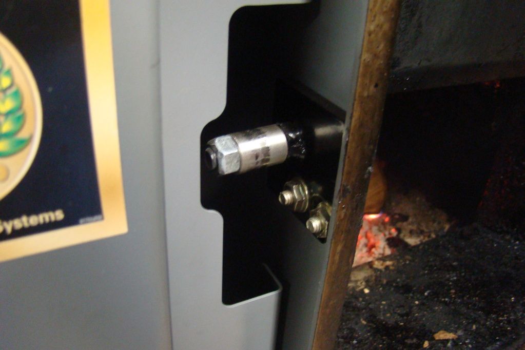

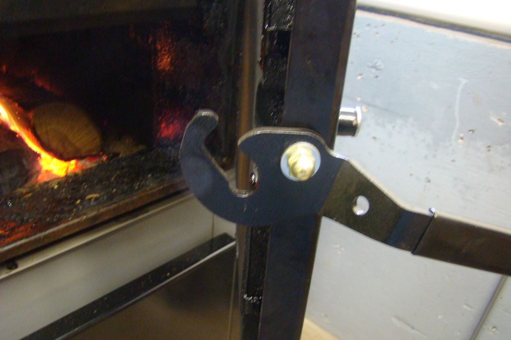

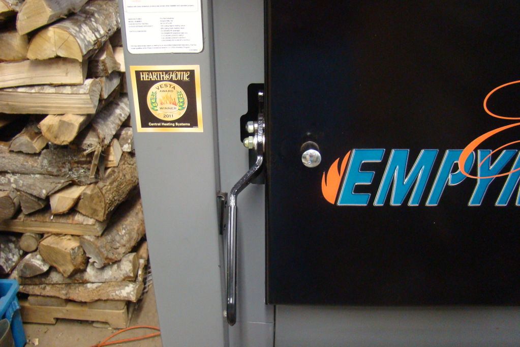

Hi again Ken,
It was you who posted about the Handle upgrade on the Elite. How much was it?
They replaced it under warranty. My boiler was allowing a small amount of smoke out of the upper handle on certain occasssion.
Here are a few pics and a video of the before problem. The smoke was only happening every now and then so it was hard to find. Click on the first image to see the old smoker. The new system places everything out side of the firebox. The old handle gets cut off. You drill a hole in the door for the new handle. Remove the side panel to put the new filler piece in, then reassemble.

The new design makes more sense. I'll upgrade if my 25 cent solution doesn't work.
