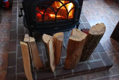

First of all I am surprised your wood is well seasoned after just splitting it this fall, but it sounds like you might have spit it too thin. How large are the splits at the circumference?
I seasoned the wood in cut lengths for about 15 months and then split it this fall. The pieces are about 20" long and I'd say the widest part of the wedge is about 4".
Try some wider splits.. I like 8-10+" for longer burns. 4" are nice for start ups, but whimpy for extended/unattended burning.

You will get to know the Oslo better. Jim's suggestion of using larger splits to regulate it for a longer burn is a good one. Adding a draft damper might help a little too.
Hi Simisita, I've had my new stove two months and the best way to get long burn times for me is to put two 8" splits on the bottom and fill the rest with whatever you can squeeze in there. The stove gets filled at 10p and at 6a there are plenty of coals to get the fire going again. The stove is an amazing heater! Hope this helps.

I stick a big fat square hunk of white oak in the back, east/west, and then as much big stuff as I can fit in after that, trying to put a crooked piece or something in front of that air inlet so as not to block it off.

I use small splits,medium and xtra big chunks. I mix and match my overnight loads. I pack it (about 2 inches from the burn tubes.) How long are your cuts ? Because that makes a huge difference. I cut my stuff to 20" I've been burning pignut Hickory at night and have gotten 11 hr burn times if I pack it good. My average is between 8-11 hrs depending on the wood and the size of the load.

Pignut hickory..Nice stuff! Simisita, how you pack it makes a big difference too. For a long burn you waznt to fit your wood together tight like a jigsaw puzzle, the idea being that air can't get through it all at once and it burns from the outside of the pile and slowly works its way in. For a hot quick fire, you load it loose with lots of air spaces.
