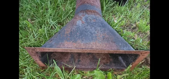

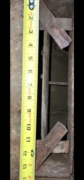

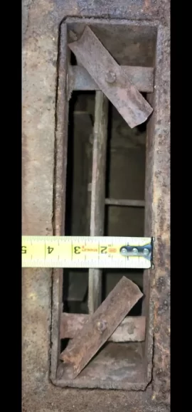

It is a rectangle. It has an adapter that gose to round.

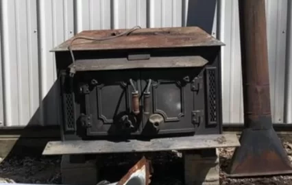

Can you post a pic? What size is the rectangle
[Hearth.com] kes squire stove model 50505[Hearth.com] kes squire stove model 50505[Hearth.com] kes squire stove model 50505
Ok those are copies of old buck stoves. It will probably run ok on 6". Does it have legs. Most of those were inserts but I think there was a leg option to use them as freestanding. I would go with 6" anyway so it will work with a modern stove when you get sick of that one. They are very primative stoves and the damper mechanism is a pain
