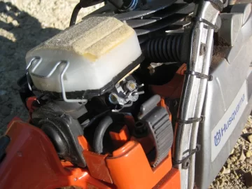

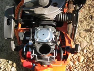

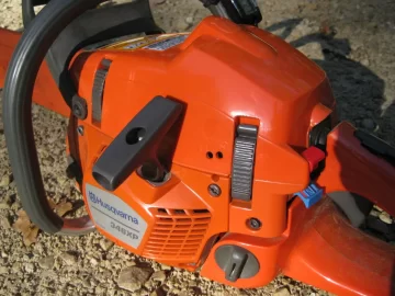

I love my 346XP NE. Scott Kunz ported it. He put finger ports in the cylinders and a bigger Walbro 199 carb from a 359. I got rid of the Chinese Zama carb and all the primer bulb crap the original Zama carb had. The saw looks like the old 346 with the primer bulb gone. The carb and filter assembly barely fit under the cover....but they do. I just ran my mostly stock Husky 350 (ported muffler only) the other day after running my 346XP and I could not believe the difference. I hit dirt with my 346 and didn't want to sharpen it, so I grabbed the 350 to finish up. Hard to believe they both are 50cc saws. LOL

Here's my 346 not long after I got it back for being ported and the Walbro 199 carb installed.
