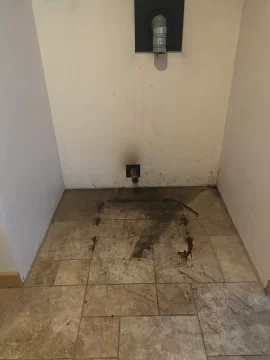

I came to here share a PSA: while it’s totally possible the tenants mentioned in this thread were negligent with the pellet stove, it is ENTIRELY possible that wind caused a fire in the hopper and I know because it happened to us this week. Hence how I stumbled on this in the first place.
We have had our pellet stove for 4-5 years, clean it several times a week when it’s being used and use it probably 2/3rds of the winter- maybe a little more. If it’s warm enough, it doesn’t get turned on and we only use it during the day.
We live in a house that’s very susceptible to weather, and we get a good amount of wind. Our stove has smoked indoors before due to wind but never this bad. During a severe snow storm and wind coming from a certain direction, it started to smoke within the house so I turned it off. 30-40 mins later the wind still had it going, and a massive billow of smoke came out of it filling my entire house with with thick brown unbreathable smoke. We had to evacuate and call the fire department. They tried to extinguish the fire inside but that didn’t work so they proceeded to rip the stove off the wall and carry it outside. It sat outside during a severe weather storm for almost 24 hrs on fire and smoking.
It was awful, and scary. Our entire house smells like a camp fire, we thought our cat was going to die, and it ruined various fabrics we had in the house. There is nothing we could have done to prevent it from happening aside from not turning it on at all that day.

We had gusts of wind that reached 80 mph all day. This happens at our location frequently. This was caused by wind.

You don’t have to. I don’t need your validation, I put this hear for anyone else wondering if this has happened to other people because it happened to us. Is it unlikely? Sure. Does it maybe take a perfect storm of events? Sure. But it’s possible. The stove was on from about 8-9am until about 3:00 that day when I turned it off and it was the first day we had used it after cleaning it in about a week and half as we had just gotten back from a trip. So the ash that was in there was whatever had accumulated that day.

All good - I don’t get upset about comments on the internet. I’m just confident what caused this issue and it wasn’t not cleaning it or improper maintenance. The wind was 10000% blowing directly into the chimney. We live on the coast of maine on a very exposed mountain. It’s not uncommon at all for us to see wind speeds of 40-90mph. It just so happened to be blowing north east - the side of my house that this pellet stove sits on.
I agree, I don’t think this has a highly likelihood of happening on average. We’ve lived in this same house with this stove (and weather) for almost 5 years and it was the only time it happened to us.
Just a use case for anyone out there. I wouldn’t wish it on anyone.

@tbear853 our pellet stove does not have said steel block. We had actually mentioned after this happened that had it had one, this wouldn’t have occurred. Lesson learned when shopping for the new one.
