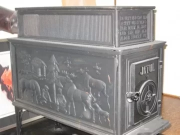

It looks good in the PICS he sent me. Says Jotul on the door. Looks Like some deer or Moose or something on the side.
I can see on the plate it says JOTUL 118 B. I'm pretty sure it is original. Unless the copies actually said Jotul on it.

LOOKS JUST LIKE THE PIC YOU SENT ME. IF THERE ARE SOME OTHER THINGS YOU THINK I SHOULD LOOK FOR, IT WOULD HELP A GREAT DEAL. I'VE NEVER HAD A WOODSTOVE BEFORE, SO I'M NOT SURE IF I KNOW WHAT TO LOOK FOR. ALSO IN THE PICS HE SENT ME, IT LOOKS LIKE THE PIPE IS COMING OUT OF THE LONG SIDE, NOT THE SHORT SIDE, WHICH I THINK WILL BE BETTER FOR ME
I owned one of these and used it for a few years. This is the same stove I actually grew up with 30 years ago, so I have a special fondnessfor it. I loved it and it should do a reasonable job in a smaller well insulated home. The dimensions are similar to the current 118, but with a different door. I think the output is 5", but whatever the size you should be able to buy a expansion piece to 6" flue--the stove probably has it already.
The 118 has a removable plate which makes it capable of exhausting from the back or either side. If you see the stove in person, check for cracks in the cast iron along the trunk of the pine tree on the side of the stove. This is a common place for them to crack. Also, make sure it has all the parts. It should have two steel plates that hang on each side inside the stove (where the bias detail is), as well as a horizontal cast plate which separates the burn chamber from the upper part of the stove.

You'll want to examine the stove interior carefully. If the side and top plates are in good condition - no cracks, not warping, then consider this a good sign. Also check the back of the stove for hairline cracks. If no problems, should be a sweet and powerful heater.
