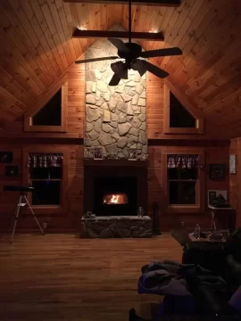

Well we made it through the night without burning the house down . Maybe i'm just being paranoid . Our old house had a masonary fireplace with a Regency i2400 slid into it . This is my first time dealing with a wood framed fireplace . The bottom of the unit by the blowers gets hot enough to where i cant hold my hand on it . The sides and top stay nice and cool .
According to everything i've read and even in the manual it says approved to sit right on plywood or a wood floor . Still seems odd to me but i'll go with it for now . Maybe this summer i'll take the unit out and do some fireproofing under it . It was not a fun project getting the stove installed , certainly not going to be fun getting it out

Nice looking fireplace! I also tend to be very paranoid with fires in the house but over the years I’ve learned that as long as I’m smart and use them as designed it is quite safe. Good manufacturers test for the worst case end user so as long as I’m burning good fuel, the chimney is clean, the air is regulated properly, and gaskets are good, I feel pretty safe, and warm. This is all assuming that things have been installed and maintained properly. Lots of things can be done carelessly to make wood burning very dangerous. I think that ash cleanout and disposal is probably one of the most risky aspects.
Looks great. All that's needed is some dwarves or vikings smoking their pipes by the fire. Is the ceiling fan running? It should be.
Dwarves and vikings haha I dont have the ceiling fans running since its 72 in here without them on . I figure why pay for more electricity if i dont have to . My whole house is electric so the less things running the better as far as i'm concerned .
I would wager that the temps up near the ceiling would surprise you. Ceiling fans use very little electricity when run on low speed. With the heat better distributed, the fireplace output can be turned down and perhaps it's blower run at a lower speed. That could equal less wood consumed or less cost to heat.
