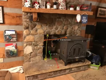

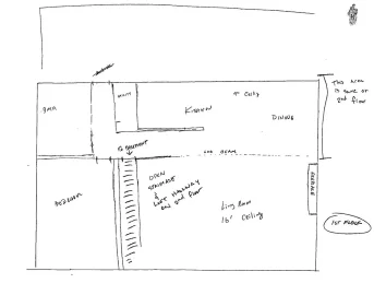

I've attached pics of my fireplace and layout if that helps. House is 1600 Sq Ft. I'm sure the Alpine insert will work, but I'm thinking of getting the Cascade so I can use it without a blower as much as possible.

I do not have an insert I have the free standing stove. It does have a very good convection blower built in. Try it without the blower and if you don't like it can you have the blower put on or install it after the fact? The stove puts out a lot of heat. I have the summit insert on the main floor and I like that as well. I do not think either route would be bad. Pe and Kuma both make very good products. The Kuma glass does not stay clean on the stove but maybe that has changed with the newer technology. The summit is always clean and has a very nice viewing when the fire is going. As I said either one will do well.

I have the Cascade downstairs and the Alpine upstairs. Get the Cascade. They are both great stoves, and we are very happy with them. We have blower on both, and use blowers at all times there is fire. We installed them as far onto our hearth as we could to allow more radiant heat as well.
You could get pretty creative as far as the surround goes. Kuma surround fastening locations are very simple. You could easily have something custom built to satisfy your wife’s tastes.

We are enjoying the Alpine. We have a 1600 sq. ft. log home with open floor plan and cathedra ceiling in the living space. We use a ceiling fan to help distribute heat. We are able to heat our house very well. The coldest its been here is 10 F, and the Alpine did well. The only misgiving I have is the small firebox. But we knew that going into it. The larger insert (Cascade) would have heated us out of our home.
