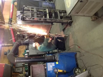

Very little $$ for electricity. We also offer a H2O coil that is a great helper for hot water (+200). My dad's electric bill drops quite a bit while using it to heat water in the winter time.
We are still backed up on furnaces right now and will switch over to sauna stoves here in the next month because we have quite a few waiting on those as well. I recommend ordering any furnaces by August before we get backed up going into heating season. We're a pretty small operation and currently don't have much room for storage even after a few small additions to the shop.
I attached a picture of Grandpa Lamppa working away on one. :cool:
