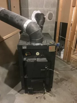

Hi I am new to this forum but I need advise.
I bought a house last year which came with a wonderful add-on wood furnace setup. The unit is a Kuuma 1.
After a few months I lit a fire and before I knew it I had a gnarly chimney fire. So after that I installed a seamless single wall chimney liner and a new stove pipe. It's drafted way better. I read the stove manual front to back and hooked it back up per the recommendations with a key damper in the stove pipe, only 1 90 elbow into the chimney, etc.
Now the crazy part is I have great wood I know pine isn't ideal but it's all I've got right now and it's bone dry. Flue temps run 400 to 450 consistently. But when I go to restoke the fire it's nothing but a few coals and when I open the smoke bypass slide the flue pipe thermometer temp instantly maxes out and sparks are in the chimney.
I can't figure it out it's like my stove pipe starts on fire and I'm worried it will lead to another fire. Any thoughts or anyone experience this before?

As far as creosote. There really isn't any in the stove pipe or the chimney liner. It's almost like the stove pipe is acting like one of those secondary burners you see in newer stoves
That pine is popcorn fart dry and going nuclear.
How can that happen when its down to coals?
There's gotta be buildup...clean steel don't burn and coals can't go nuclear...at least not that I have ever heard of or seen. About the closest thing I've seen may have been Mulberry coals giving me a spark shower upon opening the door...

Thanks for the pics...never actually seen one before.
So looking at the pics, your stove pipe doesn't look like it has been overly hot...

The fire doesn't have to be burning at all for it to happen. Even if I have coals in the firebox it still happens. To clarify I mean the stove pipe temps skyrocket and I cut the air out to choke it off. This is when I use a mirror and flashlight to look up chimney to verify I don't have fire transfer into the chimney liner. What I usually see is a small clump of smoldering embers where the stove pipe attaches to chimney liner.
I'm just trying to figure out if my stove pipe is the cause or is my furnace damaged in some way that might cause this kind of stuff.
