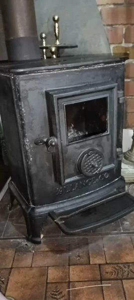

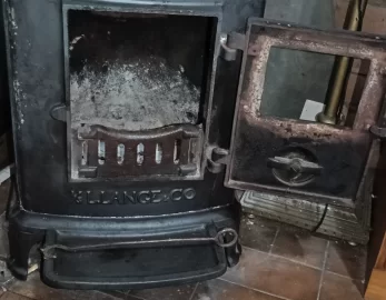

We have just bought a lovely old cottage which came with a nice old Lange stove. It has clearly been changed and modified over the years because the previous owners added a fascia. We can’t get it to burn very well and have two questions if anyone has any ideas. Pics attached to aid.
Firstly there are some small metal steps either side at the bottom that look like they should maybe have a shelf or grate on.. what do you guys think? Not sure if it’s clear in the photo but perhaps you can see it on the bottom right. There are similar ones at the top supporting the baffle. We thought it might raise the log level to get them more online with the front grate and the air vent in front of it.
Secondly it doesn’t seem to burn with the door closed and the front vent open, we always have to leave the door adjar for it to stay lit. Any ideas why it’s not burning so well? Is this just a factor of having an old stove compared to the super efficient new ones.
Any help would be really appreciated!
Thanks and happy Christmas!

I haven't seen this stove before. What is happening around the top? Is that stove gasket wrapped around the top seam? The small size and those small feet make me wonder with you if this stove was meant to have a grate in it. Perhaps it was a coal or peat stove? The door is odd for a Lange also. Normally there would be a casting on it, but this one looks like it may have had a decorative tile on it at one point?
Spencer, any chance this stove is in Europe or something? I've not seen one like it either!
With a bit more searching I have found what looks like this stove on an old UK eBay listing. It was listed as a "log burner". The model was not listed, but where that metal plate is on the door there was a window glass. I haven't found any interior pictures yet.
[Hearth.com] L.Lange stove should have a shelf?
Wow you found the exact same stove! Just with longer legs and a window where we have a metal sheet. Guess it’s a relief it was listed as a log burner! And yes we are in England.
That is the gasket you can see around the top. It also has rope running all around the front and after doing some inspecting with a torch I have found parts of it to be completely degraded and I can see daylight through the joints. Presumably that is going to massively hinder the ability to burn efficiently? I have added a couple of photos showing these parts.
I think we will ask a stove expert to come round for a look at it to decide if we should try adding a grate.

I'd take the stove apart and re-cement all seams before burning in it. This is a simple stove, it wouldn't take long to do this.

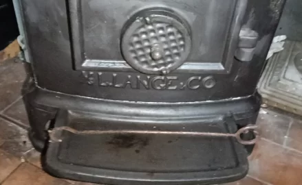

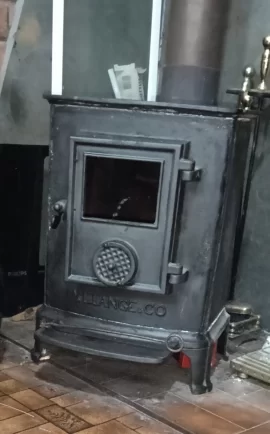

Hi, I'm in Australia and have been scouring the internet for information on my late Grandmother's Lange wood heater. I've seen some that are similar, but until now, none have had a glass window like ours does. I know it was purchased in approx. 1980, somewhere in South Australia.
It did use to be green, but needed some minor repairs and was re-painted.
We need to replace the glass as it was cracked, but my Husband thinks we should get rid of it and "Get a decent Wood heater".
So any information that could back up my reasoning and definite No! Would be greatly appreciated.

Lange stoves were of excellent quality. The ceramic glass should be easily replaceable. Make a pattern out of cardboard that fits well. Take that to a good glass shop that carries ceramic glass (neoceram, robax, etc.)
Thankyou, I have sourced some glass, unfortunately the bracket that holds the glass in has also snapped as have a couple of the screws that hold the bracket in place. I suspect a welder could easily replace those couple of things though.
The screws can be carefully drilled out, then retapped with a flat-bottomed tap. The bracket may need to be custom fabricated. Be sure to wrap the edge of the glass with flat stove gasket tape.
