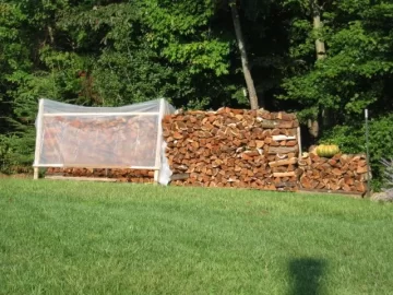

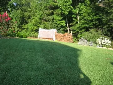

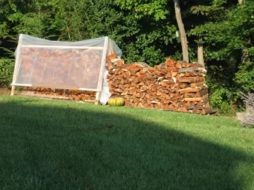

Here is this mornings work. Stacked a load of Cherry and Osage Orange. Built a solar kiln to see if they actually work.

Nice;)! How does the moisture get out of the kiln? Let us know how it works out.:cool:

I'm thinking that kiln might work better if you get the ends more open. That would allow for the air to flow through to take the moisture out, which is what we want to happen. Hope this works out well for you.

I found this article about solar kilns on here a couple of months ago: (broken link removed to http://www2.dnr.cornell.edu/ext/info/pubs/Harvesting/CC%20Accelerated%20Seasoning%20of%20Firewood.pdf)
My understanding is that the moisture will travel down the cool side (back) of the tent. I delivered a cord of green oak to a guy a few weeks ago and he had one of these set up south facing and he swore by how effective it was - he said the green oak I delivered would be ready by this December.

So the moisture evaporates onto the tent and then drips down the back? Does none of the water drip back onto the wood at all? I'm thinking of setting something like this up.
Basically, yes. Important not to allow 'any' plastic to touch the wood. My best running units have a vent space at the top on both ends allowing air to move freely.
Even if a little water runs onto the wood it's not that detrimental. The moisture coming out is internal moisture. Once it's out it's out. if it dips onto the wood afterwards it becomes surface moisture. No different than a few drops of rain. Internal moisture is the moisture at a cellular level.
