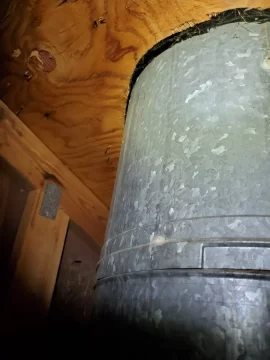

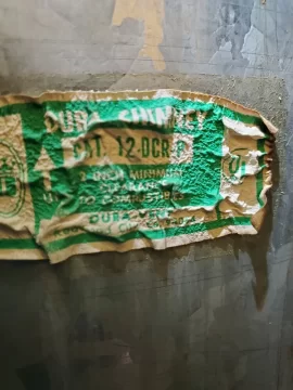

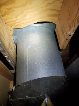

Bought a house with a fireplace in the basement, and had it inspected prior to purchase. I think the inspector missed several places that are worthy of critique. The flue goes from the basement, up to the main floor through an wood framed enclosure, then up through the attic. The clearance going from the basement to the main floor is <2" to a floor joist, and the clearance from the attic to outside is <1". A label on the flue states a clearance of 2" is necessary. Attached are pictures. My question is, how screwed am I when it comes to getting this in a safe condition? Is getting it in a safe condition even practical?
View attachment 283174 View attachment 283178 View attachment 283179

Is that a notched floor joist? If so I would look into fixing that.

Maybe I'm mistaken, but that looks like galvanized material to me. Is that ok here...?

Is it practical to fix this? Would something like replacing it with an 8" flue be possible, to achieve the 2" clearance?
First, kudos to you for getting curious and not accepting the report at face value. I hope other systems in the house are more properly done. Do you have the manual for the stove? That should indicate what chimney pipe is permitted. If not, what is the make and model of the fireplace?

Could he tear out the triple wall and replace it with insulated to get another inch of clearance? It would help in some areas but he'd still have some trimming / boxing to do where it wasn't enough.

Only if there is an insulated pipe specified for their fireplace

Dr. Seuss would be envious of the previous owner's wiring. Fortunately, I do have some training and experience in that area, and have corrected what I have found. As for the fireplace, I do not have a manual. The fireplace was installed sometime in the early 80's I believe, and doubt the documentation was kept. There is no brand or model that I can find on the front or inside the fireplace. Is there a typical location for an identifier?
Look around the door frame of the fireplace for an ID tag. Or sometimes it's behind the blower grille. That said, if it's a contractor fireplace of that vintage than it is possible that the permitted chimney pipe options are very limited.

Typically inside the front lip. Typically on the right side
