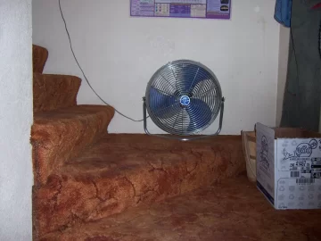

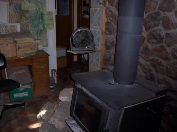

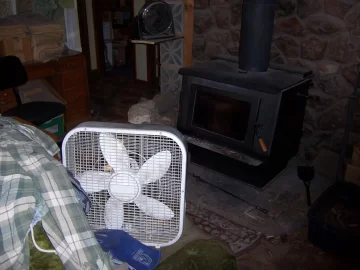

I have got a setup something like yours, and here is what I did to remedy it. I have a large two level house with my BK 40 in the lower level. It was not heating. In addition to the very small fan in the stove, I added 3 more fans outside the stove. One aimed right down onto the middle of the stovetop where the hot spot from the converter is. Then another out front to blow away the heat from the stove out into the large room. Then a third on the stair landing to blow the cold air down toward the stove, forcing warmer air to come back up the upper part of the stairwell.
The problem with this stove is that the heat stays right around the stove, so the thermostat does not open up and stay open. By forcing the heat to disperse with fans more than it normally would, the thermostat stays open and the heat gets distributed. I have had this setup for a number of years and it works.
