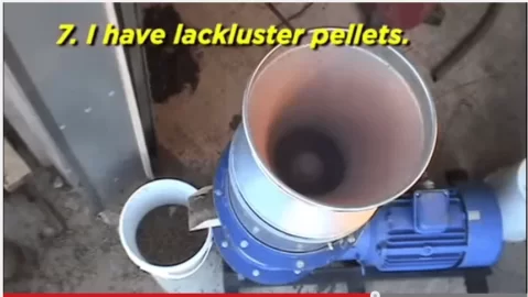

This video shows what can go wrong with Pellet Manufacturing! Good to know!
7. Lacluster pellets - Mill temps maybe too low!

Yes, those mills will NEVER generate the heat required to get the lignite to bond the wood together. That's why they sell pellet binder, which I believe is nothing more than glorified corn starch. It just won't work predictably without it. Plus the investment in a hydrometer is a must as water % is critical also.
