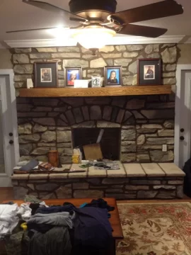

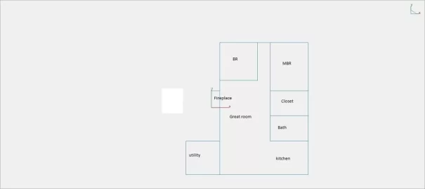

Floor plan, even a rough draft, would help, and a pic of the FP.

Here is a rough sketch of the house and a picture of the fireplace.

Nice layout for a heat producer, but now I'm not sure you even need one... Depending on your actual heating needs, I think this is one situation where an open fireplace may be fine. How much heat do you actually need? Do you have any idea how many BTU/hr you may need to have in the winter, keeping in mind that you can't turn a wood stove on and off like a furnace, of course. These are 100% duty cycle things;)
The house is foam insulated in all the walls (2x6), ceiling, roof and floor so I'm looking mostly for a small heat source. I grew up in North Alabama where it gets relatively cold so we needed the heat but it's rarely an issue down here. We had 3 frosts last year but one already this year. It was 76 today. The house stays warm just from the heat of the day that it holds. My house is basically a big man cave. I'm single and enjoy the rural lifestyle of a fireplace.
I have no idea of my BTU/hr needs but it will usually be very low. I'm am seriously looking at the fireplace doors. I think that might be my answer to my safety concerns.

I think I'd keep the FP as is and find a nice glass door for it. Should be safe. Get some andirons to prevent those logs from rolling.
I appreciate the advice and I think that is the way I am going to go. I found a couple of places with Google that make custom doors that might fit in well with the look of my house. We also have a local place that does wrought iron, I may talk with them too.
