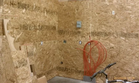

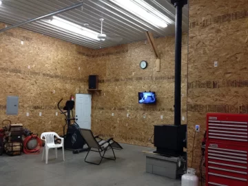

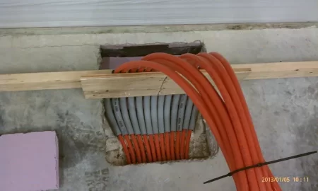

For giggles, pics of the stove in the shop plus my unused but ready pex heat in the slab.
Floor heat is the most awesome heat form ever. You will be very happy with it hooked up.
