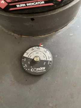

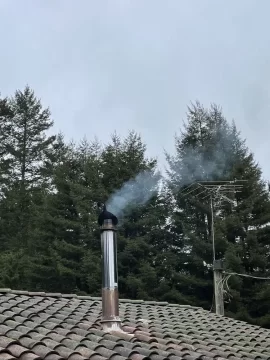

Hi everyone. I just installed a ke1107 into my parents poorly insulated, single pane windowed double wide mobile. The stove was purchased second hand with a two season old catalyst. I cleaned the cat and did a vinegar soak and rinsed before the install. The cat has a good amount of cracks but no missing material. The stove has now been going since Sunday evening and I’m trying to train Mom and Dad how to operate the hi tech machinery as they are used to a old non-epa stove similar to a Fischer.
Observations:
-Draft may be a little week. Hard to get the fire ripping. Flue is at least 15’ but I haven’t measured smoke comes out of the door if left open longer than 10 seconds
- catalyst seems to take a long time to ignite. After a reload the thermostat must be left on max high for 45-60 minutes to get the cat hot. Lots of smoke until it gets above 1000 degrees. Cut back to 3:30 position or a little past #2 and the smoke clears after a while and I think will maintain active but its cranking the heat out.
- I think it will cruise in active at 3 o clock position or #2 on the thermostat but slightly less such as the minimum of the “normal” silver zone on the t-stat and the cat temp will go down to the 500° zone on the edge of active thick whitish smoke starts up again which tells me it’s not actually active
- seems like anything less than 700° on the thermometer and the smoke starts up again and it falls down to 500°
Oh and the wood seems to be 15-17% average checked with a meter
Does this sound like a work out catalyst or possibly draft issue? Does the thermostat ever need to be adjusted or does this sound normal? Pictures are of settings and smoke on the verge of clearing

What is your procedure for using the meter?

Can you ever see the cat glowing? At what probe temp does it start to glow?

So the first two days I did see some glowing for a short time. Probably started seeing a slight glow around 1100 but I didn’t record that. First fire after install and cat cleaning it hit 1400 and we had the cat glowing all the way across till we closed the thermostat down some. Then it got brighter for a short time then stopped glowing. I’m starting to see that it stops working when it falls below 700. If kept there or higher it seems to be pushing out a lot of btus and I don’t think would see any sort of extended burn times in a full load. Not horrible just standard. I don’t think a 24 hour burn is going to happen with the cat staying active.

Yeah, you don't know the history of the cat that came with the stove..it could be into the tail end of its lifespan. But one cheap, easy thing to try first would be to add a cheap 2' section of snap-together connector pipe from the farm store to the top of the stack temporarily to see if that would improve draft and possibly make the stove easier to run.
You could check how far the tip of the probe is from the face of the combustor, to assure you are getting accurate readings. It should be about 1/2".
Actually, I probably know more about TV reception and antennas than I do about BK stoves. 😆 I don't really watch much TV but I do enjoy the challenge of getting the tough channels. 🤓😏
I hope that antenna mast isn't fastened to the utility pole! 😬 Or close enough to the power lines where it could fall onto them..

Madrona is some super dense and slow to get going wood. These things smoke. I am surprised that you are getting 15' of chimney with a double wide and not at the peak. I would expect you are closer to 12'.
If the previous owner used this stove for his heat then it could be at end of life. I've only ever gotten two years out of the last several I've put through a BK when using for full time heat in the NW. Running low on softwoods would appear to be harder on a cat since all of the combustion is happening in the cat.
How's your door gasket? Cracks in the catalysts are often a symptom of thermal shock and the most common cause of that is a leaky door gasket. This would affect your thermostat settings too.
