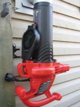

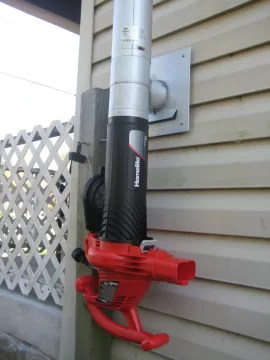

Ok... I have the cheapo Homelite electric blower/Vac from HD..
Model# UT42120 $42.00
used the supplied connection which hooked up perfect to my exhaust.
[ My Outside liner Pipe is 5" ... The Homelite piece slipped perfectly over the 4" inside pipe...
Actually had to tug a bit to get it off
The base of the blower is Smack Dab Right up against the siding had me worried.
.. Any wider blower body and I wouldn't have been able to do a straight connect...

That'll work...
Yes. The third pic that you added to the original post includes the venting termination. If I were to use a leaf blower on that setup and connecting to the venting in the same location you are, I would disconnect the vacuum hose, plug the venting termination and run the leaf blower to clean out the residual ash in the stove and vent piping from the stove to the clean out. Then I would shut the stove and unplug the piping termination and run the leaf blower again. Reconnect the vacuum hose and plug the clean out tee and you are done.
