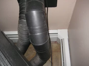

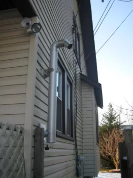

I don't have that much to use the leaf blower.
I can push down from the top down/ out to the bottom cleanout with a 4" fan brush. [4 foot].
Then push horizontal to the inside flue and vacuum that ash out from inside and done.
Always leary of sucking or breaking loose any exhaust pipe bonding or sealant gook.
Those leaf blowers got some crazy strong suction.

ok Krooser.. i'm sold.. will buy a cheapo at Walmart tommorow and do it..
btw: have a HarmanP61A.. SHOULD i have my stove door open when I do it?
don't have lot of pipe to clean [as shown in pix.] or maybe I do..
