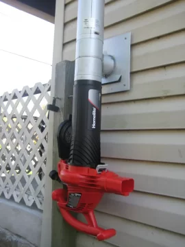

I just use what was supplied on this [Hearth.com] leaf blower trick? HD unit.
fit's nice and snug inside the pipe
