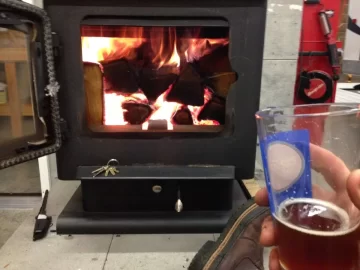

3/8 is too small. That stuff is at least 1/2". But what's the problem? I find the stove to be very controllable and as a non-cat it's far from an air tight stove. You have no less than three holes in that stove that are always at full throttle leaking air into the firebox at the top of the stove and from the doghouse at the bottom.
You don't even need to close the door!
