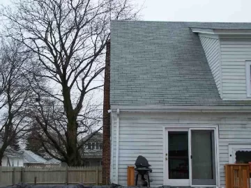

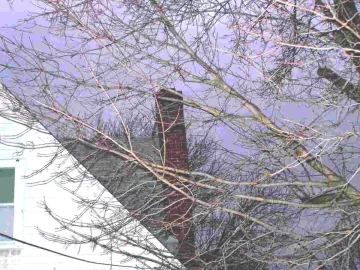

I've searched on this forum but have been unable to find any relevant discussions that would help me with my problem.
Anyway, I recently had my chimney inspected and was told that it is leaning. It is an exterior chimney and is leaning slightly toward the house above the roof line. The Chimney sweep told me I had to tear it down to the roof line and rebuild for $4500. It sounds like a reasonable price for the job but my question is how much of a lean is a dangerous lean? The house is 87 years old and its taken this long for it to lean this far. $4500 isn't in the budget right now and this isn't the house I plan on living in for the next 40 years. My thinking is that I could:
A. leave it alone. It's been 87 years and it hasn't fallen yet(I'm kind of nervous about this option)
B. Leave it alone until I can work it into the budget.(If going with this option I'd need to know where to put it priority wise since there are LOTS of things I could be spending my money on.
or
C. Brace the chimney to the roof like they do in earthquake areas. Essentially a strap of steel around the chimney attached to a 45 degree steel brace to the roof. This seems like a decent option to me since it should stop further leaning and not cost much at all to do. It would not be the most aesthetically pleasing thing but the eaves of my house would hide it at most viewing angles.
Thanks ahead of time for your help.
I've attached two photos. The front view through the tree should show the lean toward the house. The picture itself is a little crooked but if you put a ruler or something next to it using the siding as a horizontal reference you should be able to see the lean.

A. You can do this, but I'd set up a way to track the chimneys movement.
B. No comments, more of a personal decision there
C. I don't think this would help if the chimney is actually moving. Your framing is going to be no match for the weight of the chimney.
There are a few factors of why chimneys lean. Depending on how bad the lean is, it may have been built that way. It's hard to discern the extent of the lean from your pictures. From my reseach (which admittedly is not very in depth on this subject) one of the most common causes of a chimney lean is the footing of the chimney structure itself. If that is the case, then tearing down only a portion of the chimney, and rebuilding upon the same insufficient base is a waste of money, imo.
The very first thing I would do would be to get a second, third and fourth opinion on the matter. I'd be hesitant to throw $4500 bucks at a chimney sweeps suggestion.
-Kevin
I saw a chimney learning like this while walking the Marginal Way in Maine. Do you have any pictures taken during the day and not night?
It kinda looks like the lean only occurs once the chimney rises past the roofline. Is that correct? Are there any cracks in the masonry? It gives me the creeps, I would call more masons. It goes way beyond minor in my eyes.

Thanks for the replies and the photoshoping. Keep them coming.
The pictures were taken before I left for work one morning but I will go out tomorrow and take some in the sun.
I had the original chimney sweep/mason look at it a week or two ago and I had another mason look at it today. Both told me that it is leaning from the roof line up and that fixing it would require rebuilding from the roof line. It definitely appears to be leaning only once it passes the house.
I have no evidence that the chimney is actually moving though, so it could very well have been built that way. Hopefully people can get a better idea as to the degree of lean with some better pictures tomorrow.
So you don't think a brace would do much good? According to some googling it is quite common in earthquake regions. The brace is typically supported by spanning at least three joists with steel. I have no doubt that if the chimney fell it would go right through the roof but I would think the brace would keep it from moving any further since it doesn't have to hold up the entire weight of the chimney, just keep it from tipping. Once the brace was installed a repointing probably couldn't hurt in case there are any cracks in the mortar on the side of the lean. From what I can tell the mortar joints are in fairly decent shape though I have not actually been up on the roof to get a close look. I'll try to get some pics of that tomorrow as well. according to mason #2 the chimney has been repointed "a couple of times". His ballpark quote was $5200 btw.
I don't want to be overly paranoid but I have a hard time believing the masons aren't slightly biased since if they say the chimeny is fine they leave without a dime. Perhaps opinions 3 and 4 should be scheduled for next week some time. I just need to figure out a way to get a mason to look at the chimney without saying that I think its leaning. Regardless of what I do it will have to wait until warmer weather. I'm quite confident that it isn't going anywhere till then at least. Barring hurricane or freak wind that is.

This is not only a mason job but you also need the opinion of a structural engineer. I'd get them both out there together to look at it and "knock heads" (think about it together as a team) and then have them tell you what they think...... just a thought from an engineer......
if your going to pay a engineer top dollar, should just pay the 5000 and tear down and rebuild, that is a very fair price, maybe a little low
tux do you own a level? place a level on the wall that supports the chimney and report back here your findings. To me , it looks as if the entire gable end has shifted inward towards the structure here could be structual issues within the roofing and gable end structure that caused the shift inward. If the chimney were pulling away, most times that is an indication for foundation or footing settlement . This one is tilting towards the structure. It also extends quite a bit above the structure unsupprted. Todays code would call for it being braced.
Don't lean a ladder against it at the top to view it. I can tell you roofing many times, older extended chimneys were treated with kid gloves. the movement is scary
A ladder acts like a wedge as you climb it it applies your weight to the chimney It wants to push that chimney in the opposite direction of the ladder and weight applied the longer the ladder extention the more flex applied to an unsupported older chimney. Believe me think about it ,not the shtuation you want to be in half way up that lasdder and the chimney topples over.
