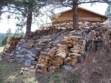

I have been in a similar situation, and I have decided to cut, split and stack as much as possible every year.
Having said that, I have certain specific situations here that may or may not apply for you.
One, I am 70 years old. I want to stockpile as much as possible while I am still able.
Two, I have unlimited storage space to store wood.
Three, I live in a place that is extremely dry, and thus do not have a concern to cover or protect from rotting.
