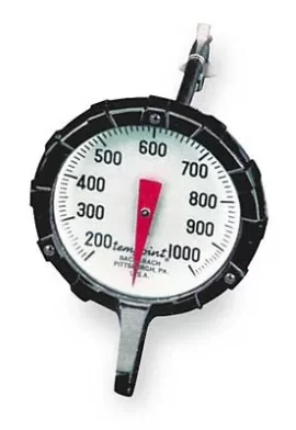

Anthony D- how did you install/ attach it so that it does not flop around?
thanks
I have one that is just stuck through a hole so it is snug. It has been in there 3-4 years and has not been a problem. I use it all the time to double check that my air mixture is good.
Sorry for the delay , the Temppoint has a cool gadget that slides on the probe and hooks onto the flue pipe and holds the the thermometer just about any were you set it . You need to make the hole slightly bigger than the probe .
Anthony

thanks- sure'nuf, when I just dug out my Bacharach kit, there it is, and I should've known that, and thanks (sincerely!) for not making me feel like a buffoon for forgetting about a feature of something I already own and have used before (though not for a long while)
