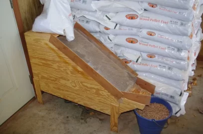

I understand some people screen their pellets. A "sluice" with holes too small for the pellets to go in, to sift out the fines. A handy person could make such a filter in less time than it would take to drive back to HD.
Simple screen will help the issue. I am glad I found a good source of pellets with no fines to feed the Italian. Its due to be cleaned today. Temps into the teens will make the project easier to climb the snow banks.
