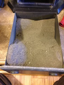

My ash pan is half full after three days burning Lee pellets and the ash pan is quite large!!
This is after only ten bags of Lee Energy pellets!! Crazy ash

Ash is the worst I've seen!!, even more than North American's

Fines are not a problem with mine it's the horrendous ash even after burning a day, my stove will be choked up in a week, I did not want to do am major clean until end of season

Weird thing about the ash it is the lightest ash i've ever seen, problem is it wont pack down like heavy ash like burning FSU
