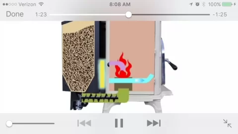

The bottom feed auger that pushes pellets up is a very different design. See pic below.
Reminds me of the old Pellet Master Stoves except this is enamaled cast iron.
