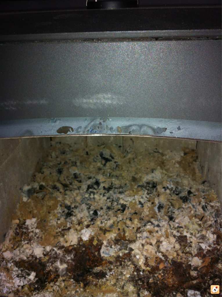

I have never seen my flue over 850 but have seen my stove top at 700 with the damper all the way closed so my question is is it over firing? And is this normal for the paint to be coming off the air wash baffle already?

And the air wash baffel almost looks like the metal has got hot and expanded then contracted causing the paint to peal off..?

I noticed it one night and put a four foot level across it and it was a bit, but soon as it cools off it goes back to normal. So is that normal just the metal expanding from the heat then contracting when it cools?
I don't know what it's called it's the strip of metal that goes across the top of the door opening that the air comes through to keep the glass clean.
That strip of metal across the top of the door opening is inside a firebox that gets up to 1200 degrees. That paint doesn't have a chance of living past the first couple of good fires. Rest. Not a problem.

This is what I was talking about last night with the paint coming off.
