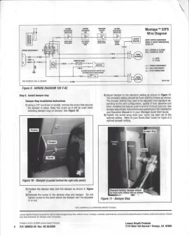

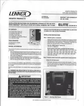

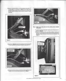

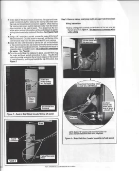

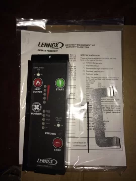

This kit contains a damper stop and new control board that resolves many issues including the possibility of a hopper fire which is the reason I got this for a stove.
Here is another issue with Tstat mode.
https://www.hearth.com/talk/threads/lennox-montage-thermostat-problem.30647/#post-512984
Your local authorized Whitfield Dealer can obtain this kit and it should be installed by a Whitfield authorized technician.
The PDF contains all 4 pages.
See pics below:
