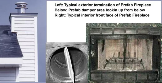

The first order of business is to determine if your fireplace is prefab or masonry. You can identify which type of fireplace you have by looking up with a flashlight toward the damper area from inside the home - wear safety glasses to avoid dust and particles! A factory-built fireplace will have a round damper and a round pipe, usually 7-11” in internal diameter. The damper plate on a masonry fireplace is usually rectangular, and approx. 6” x 24”. You may also be able to ID your fireplace by looking at the exterior of your home. A masonry fireplace will should have an orange clay liner, which is often visible at the chimney top - from outside the home. The two pictures show a typical prefab fireplace inside box and cap/termination. Another hint is to look at the outdoor enclosure around your fireplace and chimney. If it is covered with siding like the rest of the home, you almost definitely have a prefab. If, on the other hand, the exterior is solid brick which extends down to the ground, it is probably a masonry chimney. Another hint is the presence of large visible louvers and black metal facing on the front of the fireplace opening - this usually means a prefab. If in doubt, have a pro check it out for you - they can also advise you on the safety aspect of any upgrades you may have planned.
