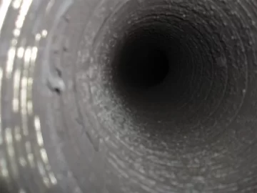

It was tough listening to the furnace run and run. I loaded at 11:30 pm Friday night and still had to shovel hot coals out Saturday around 5 pm so it would finish cooling down. This is my first year with a stove and the wood isn't perfect so I wanted to make sure everything was doing ok. Everything that came out seemed fluffy I didn't see any shinny crunchy stuff, I used the shop vac to clean it up so I'm not sure how much was there.
A nice fire is burning now and I haven't heard that furnace for a while. :)
Here is a before picture, I didn't take one after since I was pretty much a mess by then. :lol:

That doesn't look bad at all. How much wood have you gone through to this point?

Was that a top-down or bottom-up cleaning? I'm guessing the camera is looking up but there's no light at the end of the tunnel.

Yeah it's from the bottom up, it was dark outside and I've never seen light with the cap on even during the day. I wish I could have checked from the top but the 12/12 roof isn't going to get stepped on till spring. The cap screen is clear, I can see through it so I hope that is good.

Looking up from the bottom won't show the worst. While it's encouraging that the cap is clean, if at all possible, a top-down inspection will give you the best indication. Not getting any shiny black popcorn is a pretty good indication too.

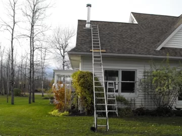

I too have a 12/12 pitch roof and I lay my ladder at a 45° angle with stakes driven into the ground to keep the base from kicking out.
I've attached a picture my set up, I still have the roof jacks up so if my fire starts acting lazy or I think I have a draft issue I'll be able to check it out. Not what I'm looking to do in the snow though.

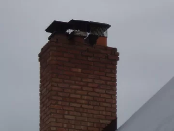

That flue doesn't look too bad, rdust. Not sure how you'll get to the cap, hopefully you're right about it being clear.
Just took a picture of the cap, it's the middle one you can see through it. It's a "deluxe" cap with a large screen so I think it'll take some a bit of bad burning to plug it up.

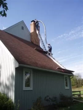

Ja, a little harder to get to than mine.
