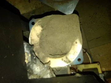

I seem to be getting a good collection of pics of problems that have caused stoves to fail. Lets see if you can tell me what was wrong.
This is a Breckwell P-24 insert with approx two years of service. It would not light and was flashing a #2 on the board. What is the problem?

Gee....I have NO idea! :bug:
Lemme guess what the stove owner said before you "fixed" the problem: "Eric, It can't be a dirty stove....I clean it all the time" :roll:
YIKES!!!!!
WOW- Looks like a mud pie in that pic

They didn't clean there vent often enough, With that flue setup.
If space permitted install should have tried to use the optional horizontal mounting kit and added a clean out Tee.
Or they have bats in there chimney. "guano"
Before I read any replys let me guess....Is that a clogged up convection or exhaust blower???

I have an insert too.........I pull my vent off the rear of my insert & use my handy homemade adapter to connect my leaf blower to my liner & fire up (pun intended ! ) the blower to clean the vent out. Then use my ash vac (not afflac !) to clean the combustion blower & the rest of the stove innards..........Keeps me off the roof too !
Thanks slvrblk, tinkabranc and macman. At least SOMEBODY got it!!!!

Im not sure just what that part is, not familiar with a Breckwell, and at first it looked like a firepot that had not been emptied, but I know thats not the case. It has a flange, and part of that flange looks corroded or eaten away at the edge. Whatever it is, Im sure the insert was not happy and would not light. Its hard to believe that the unit even worked with half that amount of crud in it.
I'd like to say its the combustion blower but Ive never seen one other than my Quadrafire blower.
I'll say its a blower that needs cleaning just as a guess. I'd also suggest you tell the owner that his insert needs a total cleanup.
