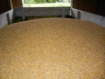

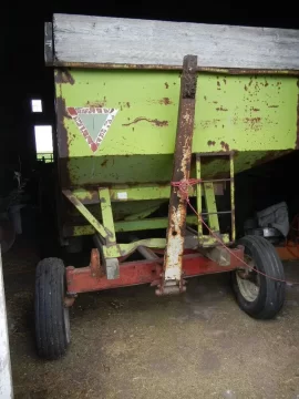

View of our old gravity box. About 45 years old.

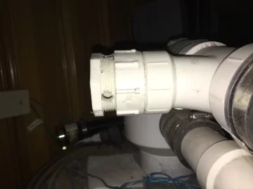

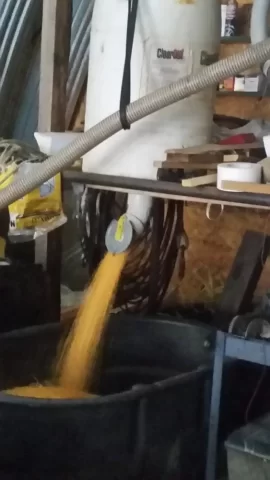

Just in case it helps, this is my 40 gallon drum setup. One important thing about using it with a vacuum - use a method to reduce the suction vacuum at the drum. My PVC parts in the top have a fitting with holes in it to do that, by screwing a fitting in or out.
Do you happen to have a Picture of the Fittings? I am thinking about Using 275 Gallon Totes to store the Corn in our Basement. But have heard that it wouldn't work with the Negative Pressure in the 275 gallon Tank. Thanks for your help.

Here's the fitting I used and modified. I added drilled holes to the threaded areas so as I screw the fitting in or out I adjust the amount of bypass air flow (and hence the negative pressure in the drum). You could also just drill holes in a plain pipe and use tape to cover or partially cover them for the same effect.

Thanks for the Response. That Should work for What I am looking to do. Couldn't tell in your other picture where you had the Fittings.

With having the Fittings did you notice much of a Difference for the amount of time it took to fill you barrel?

It is somewhat slower, but that's ok. It means the corn (or corn/pellet mix) is hitting the corn vac parts slower and breaking up the corn or pellets a lot less than at full vacuum. I have a 6.5 hp shop vac so it pulls pretty hard and the speed going up the tube is fast. It's hits the filtering screen pretty hard if I run full vacuum.
