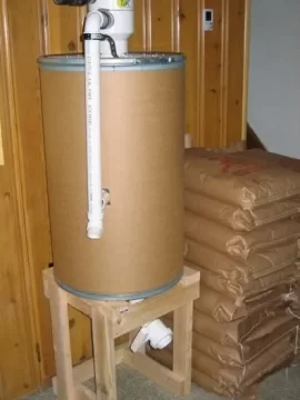

I have a 40 gallon drum I use with a corn vac attachment on top and a PVC ball valve outlet on the bottom for dispensing into a bucket.
The drum will hold about 400 to 450 lbs. 450 if I poured corn in to the top, 400 when I vacuum it in because it creates a peak of corn near the corn vac inlet and blocks it from further vacuuming.

Just in case it helps, this is my 40 gallon drum setup. One important thing about using it with a vacuum - use a method to reduce the suction vacuum at the drum. My PVC parts in the top have a fitting with holes in it to do that, by screwing a fitting in or out.
