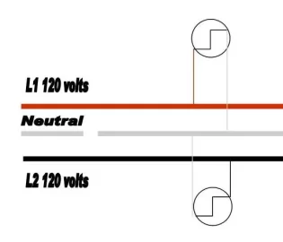

One real life experience here- about 10 years ago we had an 'open neutral'. Saw a lot of flashing lights, etc. What happens is that the loads can be unbalanced so half of your stuff is getting 160VAC at the same time the other half is getting 80VAC and so forth. So the line voltage measured at any outlet may measure higher or lower than 120VAC nominal, and it wanders all around in voltage as loads switch on and off. BTW 160VAC is *real* hard on your appliances, light bulbs, etc. When I reported this to the local power company, they got out here real quick and fixed it!
If you have an AC voltmeter and know how to use it safely, check the line voltage at a number of outlets. If it differs much from 120-125VAC in either direction, call your power company and get them out there for a look. Especially if it falls outside of, say 115 to 130 VAC. BTW you have to watch it a while, especially when you are seeing flickering. Sometimes it will look fine, then it will wander way out of spec. Your bigger loads like compressors and maybe a well pump could cause this visible light flickering, and often only momentarily as they switch on or off. But then you think the lamp is running normally but the measured voltage turns out to be way out of spec.
Here is an example on Cluttermagnet broken neutral issue he had. Each light bulb or appliance acts like a resistor completing the circuit, electricity always is trying to find its way back to ground. Depending on how low or high the resistor is on the circuit will determine the voltage. By the example you can see the voltage can range from 0 to 240 volts on the branch circuits.
Edit: If there is a ground rod in the mix it will only give you so much resistance and be rendered useless. A cold water pipe may will take a lot of current if bonded to a city water system but will eventually burn out because if inadequate wire size to handle all the current.
  • [Hearth.com] Lights have started to flicker while heat pump runs
