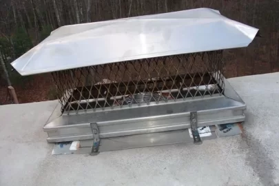

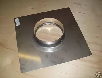

Sorry, I meant do you seal the liner to the top plate around the circumference of the liner? I already have a custom top cap that I installed over my chimney flue a few years ago and I put it on with Tapcons and L brackets. It has it's own easily removable stainless side screws. I sealed my top plate to my chimney crown under this with hi-temp silicone and Tapcons. My plate didn't come with a clamp so I can either float it or secure it with a few screws. I just wasn't sure if you are supposed to seal between the liner itself and the top plate sleeve and what to use if you do.
I have attached a picture of my existing top cap and the top sealing plate I plan to put underneath. I have it attached temporarily w/ some sheet metal.
