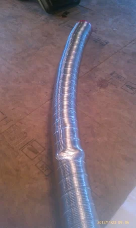

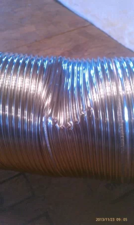

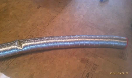

My 25 foot section of Forever Flex was dented in transit and I didn't notice until I was attempting to straighten it. My help is going to be here today to bore through the brick wall and install the liner. I really need to get this done so we can finish the hearth in time for the PH arrival next week. As background, my chimney is a straight run down existing brick and accessed by the flat roof. This was supposed to be easy!
Questions:
  1. Should I abandon today's install immediately and wait until Monday to call Olympia/Woodstock to see what they will do?
  2. Should I cut the dent out and splice the pipe before installing it? I think I have enough reach on the pipe that I could handle a 12" reduction. What to use for the splice?
  3. There are no ruptures in the pipe as of now. I don't think it will rupture unless I mess around trying to bend the dent out. Should I just leave it alone and go ahead with the install? Assuming I would want the dent end furthest from the stove, correct? I should have plenty of draft from the chimney I just don't want any safety issues (build-up, difficulty cleaning, ????)
  4. Any ideas about pushing the dent out from the inside? It is too far down to reach by hand. All I can think of is to drop a metal coffee can on a string down to the dent and push against that.
BTW the Forever Flex seems like a very mediocre product considering the price. Anyone have comments about its performance in the field?
Does the entire pipe and T assembly really just hang off the top cap plate secured by ONE hose clamp?!?! Should I put a couple small pieces of angle inside my chimney for the T to rest on?
Thanks in advance for the great advice!

Myself, I would wait and get Olympia on the phone. They can get a new liner there pretty fast. Everybody's first impression of single wall liner is that it is flimsy. It isn't. Forever Flex single wall liners have been in use for twenty years now with few problems.
It can be spliced, not something I am a fan of, but a replacement liner would get there just as fast as the coupler/splice would. But for sure I wouldn't install it like that or try to push the dent out of it.
I wouldn't use it, that's a pretty good size dent! That's gotta reduce it down to 5.5" effective area or less, plus I'd be worried about the chimney brush being a basted to get through that spot. Probably not what u want to hear Saturday morning trying to get it done.....

BB - Thanks. Without this prompt I would have assumed that Olympia was closed today. Was able to reach them and Woodstock and will have a replacement liner on Wednesday. Will proceed with the work on the hearth today and maybe split some fresh elm (if it cooperates).
