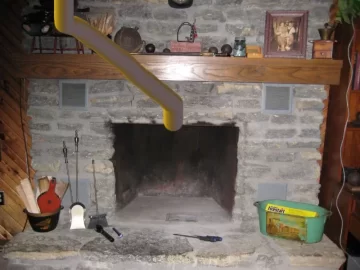

Here's the photo showing an approximation.

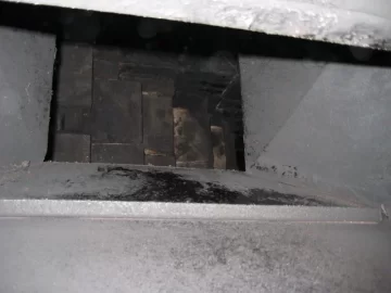

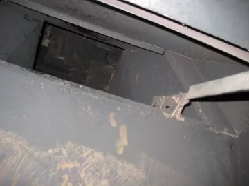

Here is what it looks like:

Joe O said:
So its a square 12x12. I.D.= inside diameter
Correct, it could actually hold the 8" liner but I was told a 6" would be considerably easier to work with,
especially after it's insulated, and likely give me a better draw.

I don't see any 90's in your diagram only 45's... but he's correct 3 foot 90 is pretty much impossible, for a 6" pipe it takes four feet to create a 90 degree angle.

The diagram is accurate and you're right, it is closer to a 45 degree turn...I'd say around 60 or so.
