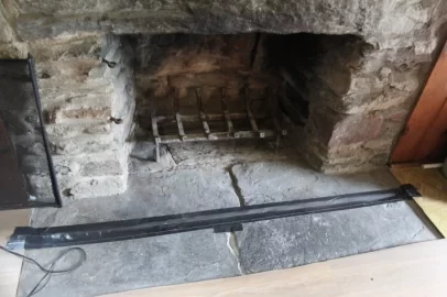

Hi all,

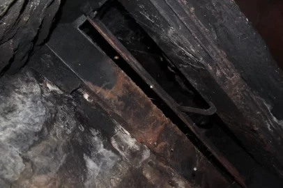

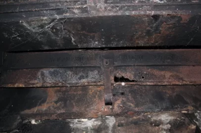

Have an Englander 30-nch on the way and am on the cusp of purchasing a liner kit when I ran into this thing. See pic. Note - the house was built in 1895 but the chimney and clay flue from the ground look new. Any advice on what to do to the damper/smoke shelf to fit a 6" insulated liner in? My husband has the tools to weld/torch/cut this to open it up if that's the only way.

Most people use a Sawzall with metal cutting blade. After shaking out a couple of teeth I just went and grabbed my Skill saw and a metal blade and the stuff cut like slightly cold butter.
I just got done doing this to my fireplace. Used an angle grinder and cutoff wheel.
Thanks it was so rusted most of it fell apart and the rest we pried out. Install went awesome. Permitted and burning our second fire now!
Yep. Angle grinder with cut off wheel is what worked for me. I darn near cut the whole thing out too
I like to give it a couple whacks with a hammer as sometimes you can loosen it up and take it out in one piece.
If that doesn't work, grinder with cutting wheel makes quick work of it.
+2 on the angle grinder and cut-off wheel. I used it on both of mine!
You need to cut the damper out and make room for the stainless liner.
I had to use a small demo hammer on one to get the liner in place - had to remove some of the fire shelf.
