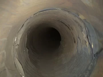

Don't know if you remember my previous posts but my liner was failing during the cleaning. Brushing top down when I get to the bottom 3 feet the problems persist. As I go up and down with the brush the up motion snags the inside of the liner. And I end up with flaps.

It is almost 3 times as thick and does not have an unsecured bottom edge. It is a completely different construction. Regular light wall will not do that either it is just that crap 2ply liner that does. It really is a bad design.
