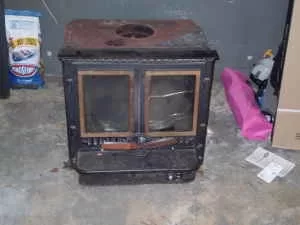

heres the stove
  • [Hearth.com] liquid paraffin

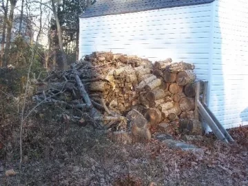

here the wood pile, split it should be about 3 cords, theres a lot of big logs buried behind the pile

does anybody recognize this stove, I can't find any info on it? I can't find a name plate
also theres a H pattern piece of steel that sits above the grate in the inside of the stove, I figure it must be for air, I usually leave it to the right and it seems to work fine when I adjust the bottom air ring on the side of the blower

The number one thing to be concerned about using your wood stove is safety. Looking at your stove, its likely you may have a number of places where air can leak into your stove making it difficult for you to control the temperature of your fire. If the fire is given too much air it can overfire, meaning the stove will reach temps of 800-900 degrees or more which can damage your stove, cause greater risk of chimney fires or even set your home on fire, all sorts of nasty stuff. Your chimney hook up while it may "worK' also is in peril of letting flue gasses back into your home causing carbon monoxide poisoning or other hazzards. In short, your efforts to save a few dollars may be putting you at substantial risk for far greater harm of one form or another. It is vital your chimney is safe and you should have a qualified chimney sweep inspect before you use your stove any further. At the very least, it is almost certain that some of the gaskets on your stove need replacing, and the crack in the glass on your door may be an air problem as well. Looking further into the concern you have about gum as a fuel, assuming you are using blackgum, its not a bad wood to burn and sap etc should not be an issue.

My professional opinion is that you have a dangerous setup if you just slide that stove in there and fire it up, period. If you're a gambling man, and are looking for a crapshoot with your life, go for it.
And, my guess is you got about a cord and a half of wood there against that shed.
Just shoving in the stove without any stub or full liner is called a slammer. Any decent stove installer stopped doing this kind of installation years if not decades ago. It isn't safe.
The wood on that pile, may or may not burn very well. It's been sitting on the ground, unsplit. The wood should be stacked, off the ground and the larger than say 8" rounds split so that they can dry out in the middle. Putting an accelerant on the poor wood in a stove is stuff for a jackass movie.
Burning the wood if wet, in a slammer installation, with a barely controllable stove has all the ingredients to be a quick route to disaster.
hey thanks for all the advice, I think the guy who told me it was ok must have had a slammer installed
I think I will pull the stove and sell it while there is still winter left.

I'm burning that stove's twin brother! I'd be really interested if anyone here could ID it.
I inherited this stove when I bought my house in 2005, it was in excellent condition--glass in tact,
gaskets seal well--but it was a slammer install. After a few test fires and a little research, I
decided to upgrade the install with a direct connect (8" boot, 5' of 8" ovalized SS flex to the first
8x12" tile and block-off plate). DIY, this cost me a few hundred $$, which is all I would like to
invest as a newbie just burning a little on WE and evenings.
As for the stove:
1. It's a coal burner--you described the shaker grate--and you're close to anthracite country.
2. It seems that most folks are ok safety-wise with burning wood in a coal burner. When it was
sold, it might have been billed as dual wood/coal, who knows--haven't ID'ed it yet.
3. Specs: about 2 cu ft firebox, wide, deep, and short. No firebricks. Shaker grate and a little
underneath air. 8" flue collar on top. Pretty heavy gauge plate steel, double-wall insert stove.
Blower. Steel baffle plate. Airtight (fire collapses fast when vent closed). No secondary. Door
activated air-bypass to reduce smoke spillage.
So, mikew, you face the same choice I had, in order of cost--use the slammer (easy NO), upgrade
to direct connect, SS liner, SS insulated liner, smoke teleporter to stratosphere, etc. Or you could
sell the lovable POS. In the end, I'm satisfied by my 8" direct connect choice (the cheapest code
option). With my 8x12 tiles, an 8" liner would have been impossible/very expensive ovalized, and
a 6" would not have been code. If/when I did upgrade to a real stove, I'd have to rip out the 8" liner
anyway. Moreover, since this old stove was not designed for a liner, a liner might overdraft it.
You can see that the 8" flue collar makes it a bit of a white-elephant.
Performance-wise, this thing burns clean (clear stack) when its hot, and cranks out a lot of heat
when you close the air down to the lowest clean setting. Air wide open, there is very little heat.
Heats my 2200 sqft house single-handedly down to about freezing. I have been trying to estimate
the stove's efficiency by tracking what weight of wood I need to burn to keep my oil boiler quiet.
I got 33% from the slammer version, and 50% for the direct connect and block-off. I figure
the air leak around the surround was stealing my heat.
FWIW, if I had an exterior chimney, I probably wouldn't have tried all this.
Finding hearth.com, I got a touch of the liner envy, and regretted my lowly direct connect. And then
I read that ELK was running two direct connects and now I sleep well at night (um, with the stove
all burned down).
