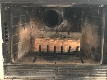

I'm wanting to put a stove on the hearth.
Wondering what options i have.
Currently the insert is removed and the center of the elbow coming from the chimney is about 21" ht. from the hearth. Box space starts about 6.5" up from the hearth and is 37" wide from the beginning narrowing to 28" wide where the elbow is.
I think the Regency hearth heater will fit, but wondering if there are other options to consider. Hopefully something with a bigger firebox.
Possibly the Hearthstone hearth mount?
Others?
Thanks for any suggestions!

The width is 36". It's about a 21" height from the floor of the fireplace to the top, but there is part of the metal framing just after the opening that comes down making that spot only 20" high.

i'm fine with that. the back of the pipe coming down is about 2' from the back of the FP.

The stove back vent goes to a double walled horizontal pipe which has a very slight incline into the elbow pipe that then goes up through the chimney. Pretty sure this was done right. It's going through double walled pipe the whole way.

Oh, you thought it was venting direct into the chimney. Got it. No, it's in pipe the whole way that was run originally for the 2700i.
That's what i meant by the elbow that comes down into the fireplace. Sorry that wasn't very clear from what i wrote.
[Hearth.com] List of Backventing stoves that will fit a 22.5" wide hearth
This is it with the Isle Royale removed.
