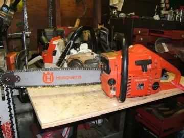

Garage sales are OK sources of saws, but they're very unpredictable. You might have better luck checking with local dealers. Most I do business with regularly sell gently used saws for very fair prices. And every once in a while, you can even find a nifty unused old saw at a saw shop, too, like this Husqvarna 238se I just scored. It has never seen fuel, still had the tags on it, and it was covered with dust from sitting in the back of a shop since 1985...

Nice score computeruser!
Is that an old Stihl 036 behind it???? (my favorite all-around saw).

The saw in the background is an early small-pin (10mm) 044. I've been wanting to get an 036 for a while now. They're great all-around saws, but I'm not sure what role it would fill in my saw lineup that isn't already filled by other saws. Heck, I'm not even sure what purpose the 044 serves since my 7900 is my go-to saw 90% of the time anyway.
