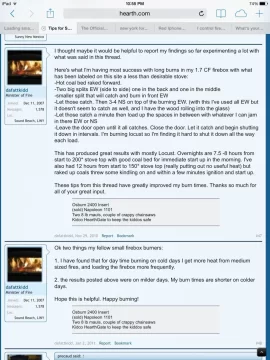

Here is a thread I started a few years ago when I was burning in a 1.7 cf Napoleon 1101 insert. I believe this is the thread Fiona was referring to. https://www.hearth.com/talk/threads/tips-for-small-fire-boxes.57987/#post-57987
My conclusion is in posts #47 and #48. I attached a screen shot of those posts. This is what worked for me with my set up. I hope that's helpful.
