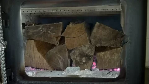

Wow.... That is loaded. I just took this pic to post in the thread about packing a stove..
This is an average load. I try to keep it around firebrick level. This one is a little higher in spots, but I get up at 4:30 for work. Just loaded it 10 min ago. I normally pack it a little tighter, but dont have to last long tonight and there will be Plenty to re-light in 7.5 hrs.
Never tried the coals to the right yet. Read a few of your posts stating that. Gonna give it a shot tomorrow. The right side, is the side that keeps wood the longest and gets the least airflow (in my set-up). Is this the reason you do it on the right?

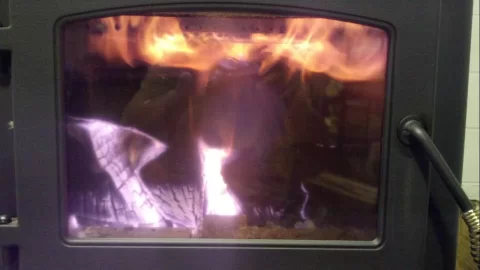

This is the same load. In the time it took me to type the last post (posting from the Droid Bionic). Within 15 min, got secondaries and damn near shut down.
Thats the only reason I like to load N/S and leave a 1" gap in front of the doghouse. To let that super heated air, run to the back of the stove and come across the top of the secondaries. If I block it, I get a large flame in the front of the box. Which isnt bad. But takes longer to get to temp. Stove is in the basement, so the quicker it gets going and I can turn it down. The better off I am with the Wife.....
Definitely trying the coals to the right thing tomorrow after work...

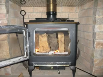

I loaded my 30 with 5 slabs of 2 year old white oak totaling 70 lbs and got a 12+ hour burn. If you load on coals and it doesn't ignite quickly just hit it with a match and it will take off. I use a propane torch.

There is my favorite overnight load.

You can get lots and lots of beauty sleep with that load BB.... :lol:
Quite impressive load. I would love to see that fired up.

That's a nicely loaded stove, boy do I miss those days. Throwing bags of pellets in a hopper just doesn't give you the same thrill :-)
I picked up on that wet split up above too, but I wasn't gonna say anything! Those 30's can take huge loads heh? My DW was similar to load from the side door. Couldn't fit nearly as much wood though.
