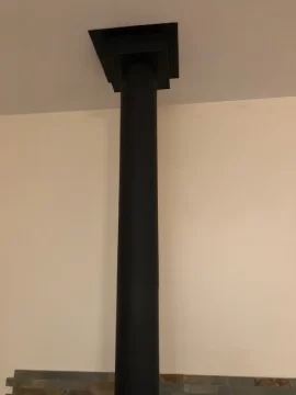

Then last week, a plumber who had worked on gas stuff was here doing some plumbing work, and I told him about the issue, and he looked at it and noticed that there are two holes where there are no screws, near the top of the round black part that comes up from the wood stove and enters a square black part that's attached to the ceiling (sorry, I don't remember the terminology). Some of the holes up there have screws in them, some don't. However, he didn't think that would be enough to cause smoke to enter room.
Because I really want to use the stoToday I climbed up on the stove and stuck two small screws I happened to have on hand in those holes, but they don't actually screw in, they just slid in, and they don't sit completely tight against the metal. While up there, I also noticed a bit of a gap where the round thing goes into the square thing. I don't know if this is where the problem is. I didn't feel any draft with my finger when I held it over the empty screw hole though.

I think it will help if you post some pics of the locations you mention and flue set up so that others who know the stove are better informed.

I'll include some pictures here that I took yesterday. The area of the cord that came off and had to be reglued is on the upper right of the picture showing the inside of the door. The door is on the side of stove. The missing screws can't really be seen because everything is black, but they're near the top of the round column portion. Not sure if these pictures are sufficient?
I will also answer the questions. It's definitely smoke smell and not chemical smell; the chemical smell really bothers me, so I'm very sensitive to the difference. Very rarely I run the stove vent fan while wood stove is burning wood, but I've only done that about 2-3 times and open a kitchen window near the stove when I do that. HVAC is always off when wood stove is burning, and bathroom fan never gets turned on. House is new and very air tight. There is an outside air kit that enters stove from the wall behind it (it then goes down inside that wall to basement just below it, and runs along basement ceiling to the outside wall). The distance from top of stove to ceiling is about 5.5 to 6 feet.

I do think the pipe with missing screws is a potential culprit, especially if it got deformed a bit - though it should normally suck air in and not let smoke out.
